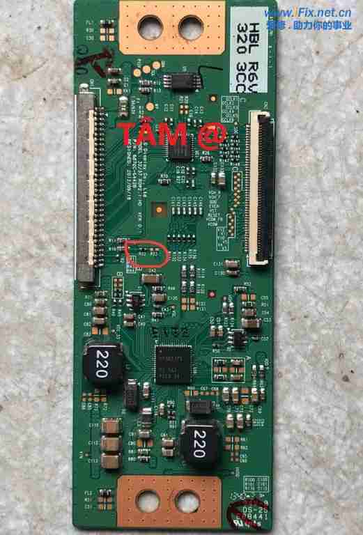

-B1: Remove the U5 memory (404RP) on the Tcon re-read the file
-B2: Put the read memory into the Hex pm edit the first 6 cells of the top row -> cell D2 to 00
-B3: Reload the modified memory file into the IC memory and re-solder as the tcon image will rotate the image in the right direction
-Note: After rotating the picture is the correct way but the letter is reversed, remove the R22 (1K) is going to run out of words.

-B1: 卸下 Tcon 上的 U5 内存 (404RP) 重新读取文件
-B2: 将读内存放入十六进制 pm 编辑顶部行的前6个单元格->> 单元格 D2 到00
-B3: 将修改后的内存文件重新加载到 IC 内存中, 并重新焊料, 因为 tcon 图像将在正确的方向旋转图像。
-注意: 旋转后的图片是正确的方式, 但字母颠倒, 删除 R22 (1K) 将用完字。
翻译了一下

Sir your parsanal check ok yes or no i am edit same row mirror work ok but picture not clear picture show some dark or conwarjans type
发表于: 2019-9-28 17:08:04
sir is not working my self test tosiba set model no 32p2305ze
发表于: 2019-9-28 17:11:03
if your ok bin save then send me plese
