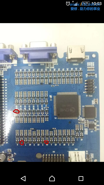

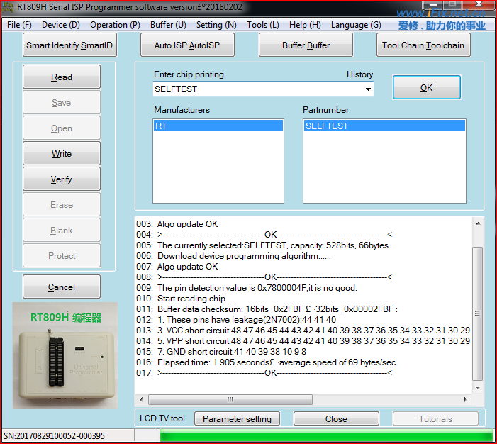

RT 809 H error code and repair 2N7002 tr
 楼主| 发表于: 2018-3-23 15:10:01
发表于: 2018-3-23 15:26:17
Replace this device
2N7002 is N MOS   60V
Please refer to the device specification for parameters。
