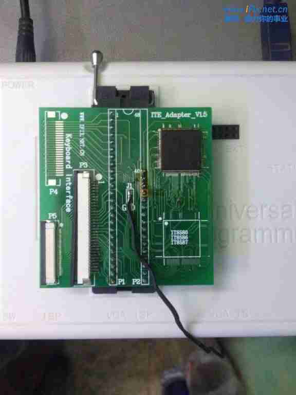

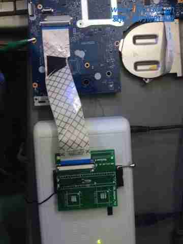

hi all i have rt809h and ty to charge it8586e put i dont know problem
 楼主| 发表于: 2017-10-10 10:40:19

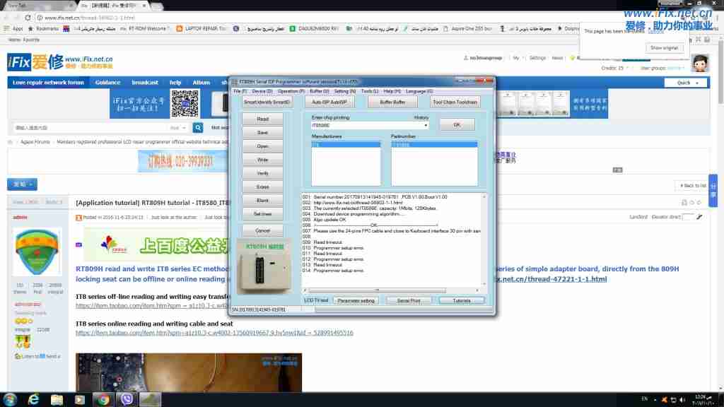

cant instal software to it8586 what is problem i have rt809h and adptor and when try to connect read timeout and programmer setup error.what is problem?

 楼主| 发表于: 2017-10-10 11:17:18
thanks for replay .I have seen the video but have been decrypted from the board. I want to charge it via a 30-bin cable
 楼主| 发表于: 2017-10-10 11:18:53
i need make it without remove it8586
 楼主| 发表于: 2017-10-10 12:32:21
i remove it from motherborad and the same result. read timeout and programmer setup error.what is problem?
