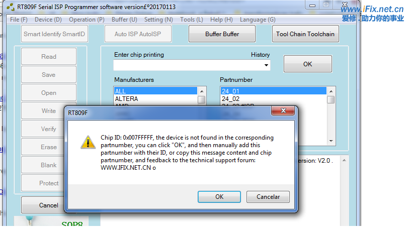

RT809F连接不上
发表于: 2017-1-25 19:13:37
rt809f não reconhece nand flash H27U1G8F2BTR
有人幫我
发表于: 2017-2-4 16:00:24
有人幫我
Your ID should be unusual, resolve the chip and the bouncing seat, locking seat contact problem,
 楼主| 发表于: 2019-6-22 11:47:43
谢谢各位 已搞定 是编程器的USB座子坏了
