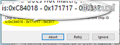

I have a new BIOS that named GD25B128ESIG. I tried to add new device but have not done. Anyone guys please help me. Thanks in advance
Select GD25B128C Ignore ID Read.Read check to see if it is normal  发表于 2023-12-20 14:02

Thanks, let me try
