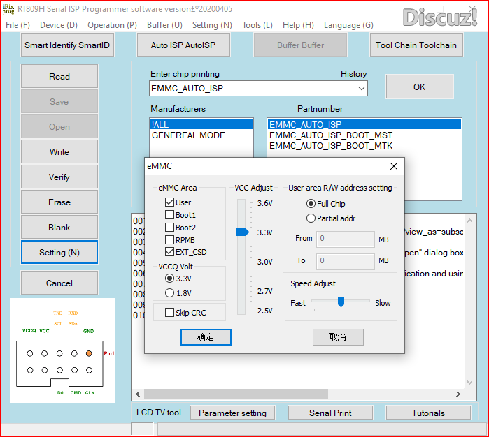

I learn everyday from masters. You just pointed an interesting point.
Does it mean when reading and writing Data on all MTK RTD AMLOGIC HISI, i must put off Boot 1& 2 on the SETTINGS, and only read and or write on the user area?
发表于: 2020-6-7 14:36:02
electronics 2020-6-7 08:16
Does it mean when reading an ...
MTK, RTD, AMLOGIC HISI, these solutions just write the user area,
